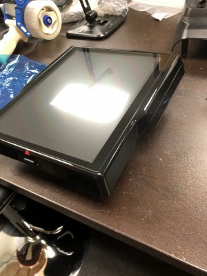

WeChat_Image_20170815234522_1024x1024.jpg TB2uvemXYMlyKJjSZFlXXbMoFXa__2222177650_1024x1024.jpg

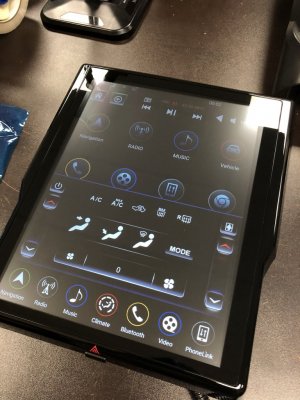

I have tried to search the thread and I’m getting no luck before anyone jumps down my throat. I have a 10.4 running 7.1 in my 2015 ram 1500. I have a few issues but the biggest is that my hazard lights button doesn’t function and the provided usb and factory usb don’t work. Does anyone have a diagram of where things are supposed to be plugged in etc?
The last picture in this post show the board where the ribbon cable is plugged in for the hazards. It's a flimsy connection, try to re-seat that cable.
The USB plug on the back of the radio is the only plug that can be placed into the wrong hole. Make sure it's in the correct spot.

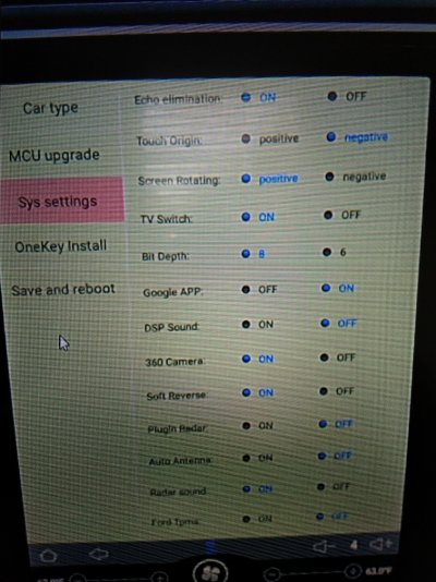

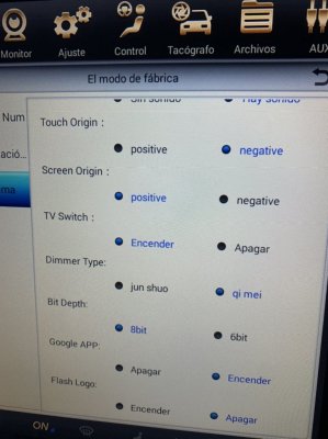

Are the screen touches accurate or does it press somewhere else on the screen when you press too?
Wayne Stella
May 26, 2018
139
81
Goose Creek
Yes they are accurate. I even tried updating the firmware like we had tried before and I get the same result. Its like the graphics card blew up and decided to stand on Its head.
SitKneelBend
Moderator
Member Relations Specialist
Jan 8, 2015
11,026
7,760
St. Louis
3.6 Pentastar
There is a setting to change that. Change whatever current value is set for "screen rotating" and "bit depth" to the opposite of what is currently set... 3050a458bdba4b745bb96b9a55c254a8.jpg
Wayne Stella
May 26, 2018
139
81
Goose Creek
Thank you. About the same time I got a reply from Phoenix folks on the Tesla fb page said the same thing as you. I was able to get it fixed so it's usable but still no audio controls

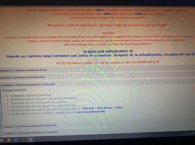

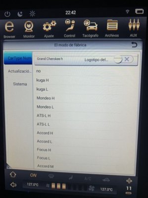

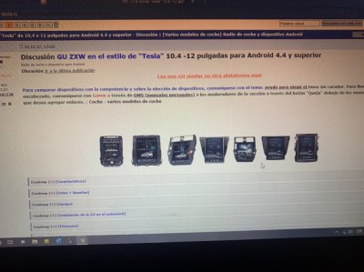

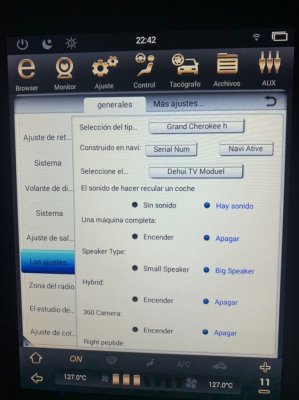

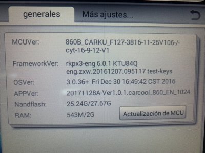

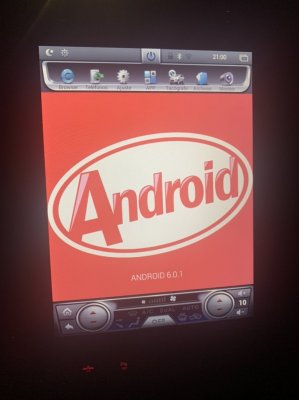

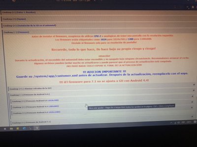

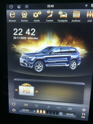

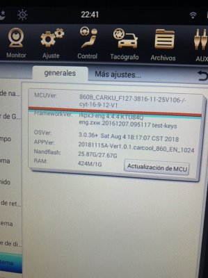

Good estimates, excuse my English but I am Chilean, can someone help me update my tesla style radio that is not from Phoenix but from China and the firmware that the current one was 20180824A_1024x768_ROOT.img which worked well but then I wanted to try with 20180914A-Ver1.0.1 .chwy-EN-1024_ROOT_HYBRID.zip and it produced this problem of screens I have reinstalled the previous firmware but I have not been able to solve it

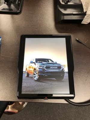

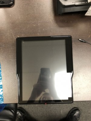

Good News for 2019-2020 Ram owners. Linkswell is releasing a 12.1" Radio for those new trucks. Attached to this post are a few photos of it, and we haven't installed it in a truck yet, and we plan to begin testing next week, (12/7/20 - 12/11/20), but this unit includes all wires needed for install in ANY trim 2019-20 (and probably 21) ram trucks. MSRP is $1,295.
It's not on our website yet, but I plan to add it to the website in the next week or two. If you placed an order through a Linkswell retailer, they are able to order this new product from us.
Link to more photos:
https://www.dropbox.com/sh/gjozmdxiq8b1zv3/AAB350jWZpt0J478lHeRec1Ra?dl=0
