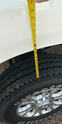

I set dead level with the 2 inch coils. i have the fox 2.0 at all 4 corners and there great! I have to wounder with fox this good. kings must be heaven.

Can I pester you for a front fender measurement when you get a chance? As well as what size tire your running

Ya i will get one when the sun comes up. Im running the stock 275-70-18

got you a few different ones. the one is hard to see the tape. if you want something specific let me know.

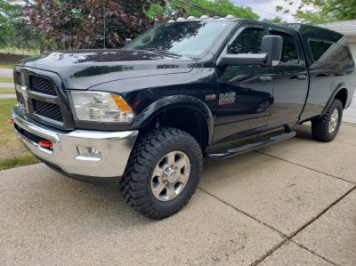

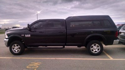

Hello Freed, I went the RC 2 inch spacer level on my 16 2500. You will need an adjustable front track / panhard bar to recenter the front axle. No matter which way you go with th lift / level it will cause your steering wheel to turn slight to the right. Bullwinkle is now riding around on 35 12.5 18 on factory rims. First pic stock tires with level, second with 35s.

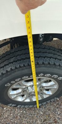

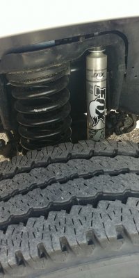

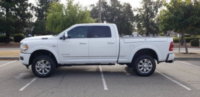

I just did the Thuren 1" coils, Sway Bar and Fox 2.0 on all four corners on my 2020 2500 last weekend. Thuren stated 1" lift exactly, I got 1 1/2" exactly which is fine. From center of hub to bottom of fender I'm now at 26"F / 27"R and I also kept my stock rear coils because it too is a DD as well as tows my trailer. It rides SO much better even in the rear! If the wife noticed and now enjoys it then it's worth it. I'll probably do the track bar in the future but it's good for now as it only has 3,850 miles on it and I really don't drive much.

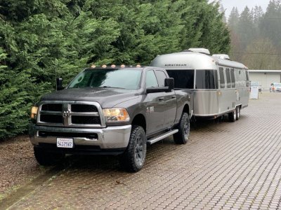

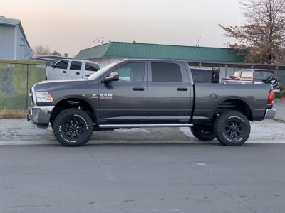

My 3500 has 35" ko2s and thurens .5" all around. I did the full kit including bump stops, track bars, sway bar and steering damper.
Attached are before, after, and towing with ~1000lbs of tongue weight. It's hard to tell from the angle of the photo but it still has a smidge of rake.
I wouldn't want to go any softer or higher.
