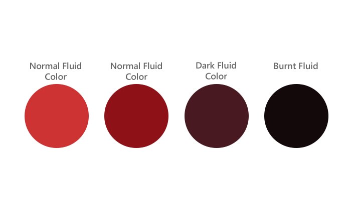

I would say most of my miles are what we call country 50, as in 50mph, maybe 30% or so city the rest country 50 and freeway. I was surprised how dark the oil got at less then 30k miles. Now it is 8 years, but whatever only 30k miles. Thanks Syn for that pump idea, great purchase. I'll get the link to that in a minute.

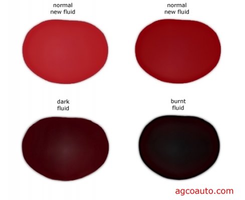

New automatic transmission fluid has a bright to dark red, translucent color. The red color is the result of dye that is added to the transmission fluid for identification. Color is NOT an indication of the quality of the fluid nor the condition. An automatic transmission can have a significant amount of wear and still have clean red fluid. It could also have dark fluid and still be in great condition. The color of automatic transmission fluid, taken out of context, means very little.

Yeah Josh, factory fill. at 30k miles 8 years.
Well, if you like you can run tranny fluid til it's black, no transmsion shop would say the same thing. In fact they all have the swatches on time to change fluid. My fluid was well past the second swatch and well into third level of black. I'l get another picture tommorow, if looks very dark purple just as in the warning swatches you see from tranny shops.

Take an eye dropper - and drop 1 drop of the old and drop one to the new. You'll find it's not that dark. But good idea to change at 30k I agree.
