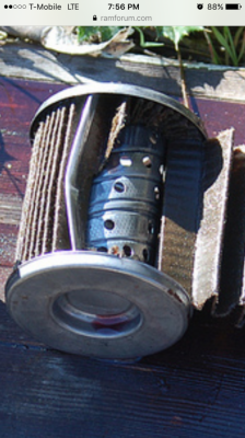

After looking at that paper spin on filter it Beggs the question as Why? Engineers that design these transmissions have got to know paper can't go 120k. Makes me wonder why they have it in there in the first place, if the sump filter is synthetic what would be the point?
Thanks Burla for the First ever tranny filter cut-up.
Why not make it an inline filter instead on inside the transmsion? It is just stupid, and we all buy this garnage because we have no choice. But, it is even getting worse with newer trucks.

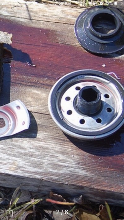

The seal is made with the O-Ring though so as long as that seats you should be good right?
Sent while firmly grasping my redline lubed RAM [emoji231]
but, the oring relationship to the top of the threads has to match. Put it this way, I'd just have a factory spin on filter on hand when we find a replacement, just in case.

I'm gonna try and get that plastic out w/o damage, now I can at least find something with the same top size, and I need that in tact to find the right thread size. These are different then our RP filters, the threads are smaller dia.
I think it's an 11mm Allen?

I don't need the outside in tact, just the part that goes into filter. Prolly just use pliars. Next mod, drain pain with change bolt. I got at least 3 quarts maybe more from dropping pan the extracting alone. I wont **** with that seal garbage again, the sump filter will protect this transmsion, all we need is spun micro glass spin filter, only deal with fluid from now on and do it often. None of those filters had any metal or clutch material, nothing, and nothing in the pan.
Our engine oil filters are 22x1.5
Im fairly certain the trans is 20x1.5
I measured both sides of that metal filter thread and they both seem to be the same.
