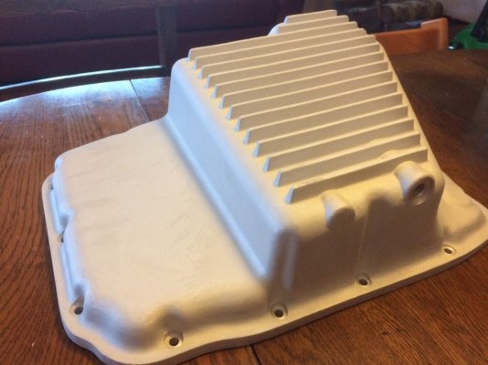

Anyone use the 68RFE Mag Hytec Pan on the 66RFE? With what’s been discussed in her and the Synthetic Oil thread, I’m going to do this Mod. I don’t think I’m off losing the truck, but if I do, I’ll just sell the parts.

Also, Everyone go with the Mopar RTV it has anyone used Permatex Auto Transmission Gasket Maker?

Now I’m going to be like SyN and ask if you could snap a pic! LoL sorry!
Also did you get the step to clear the exhaust?

Cast finish from PML painted white. Is this pic good enough? Or are you looking for something else?

Nope that’s perfect, do you think their deeper one would fit with the exhaust crossover? Or did you get the Deep Step Pan for that reason?

Drain plug on the opposite side?

Drain plug

I dont think the pans without the step will fit but if any of them do i bet it would be the 10304

Does it all drain out with the shape of it? Looks like the deepest part of the Pan is opposite side from the drain plug.
