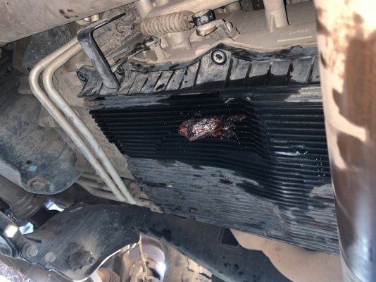

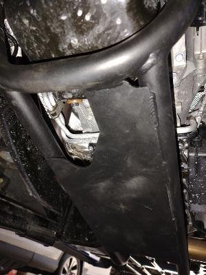

Yes I have damaged my OEM PLASTIC pan. Elk hunting I backed up over a juniper stump hidden in tall grass. Lost all fluid within a minute, had to pull the neutral strap and get towed out of a nasty 4wd trail back to camp, go into nearest town (different truck) and picked up the last pan Napa had in stock plus fluid. Had to make 2nd trip the next morning to get a hand pump to fill it and a torx wrench set to get that damn bolt above the exhaust off. let’s just say skid plates were ordered right when I got home after the TT blew a tire on the way. FUN TRIP
