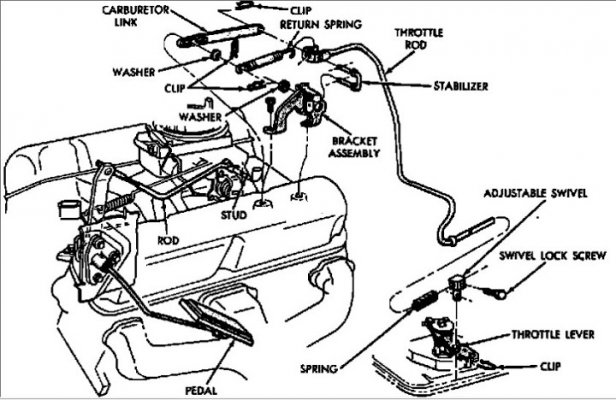

I've only had the truck for a couple months, been doing lots of transmission work trying to get it running. When I went to start it up and drive, it started just fine, and went into gear just fine, but it received no feed when I stepped on the throttle. I discovered that, where the throttle come out on the side of the carb, a piece of what looks like it should be linkage is missing. It looks like it should be about 4-5 inches long, on would side would maybe have some kind of a bolt or screw head, on the other it'd have to be able to slide onto a bar and be clipped in place.
I need someone to tell me what this part is called, and if I could find one at a parts store or how I could get my hands on it.
It's an 88 d100 with the 5.2 liter v8

looks like you might be missing a piece of the kick down linkage and the throttle cable. really hard to tell from the pic. really need a pic from a bit farther back with the air cleaner off.

you may want to check transmission fluid level. most likely low or burnt. looks like you might be missing a piece of the kick down linkage which would cause the transmission to burn out.

Are their any car part stores that might have linkage that old? Or am I just gonna have to get lucky at a salvage place to find it? Or if I have to manufacture my own, how would you suggest I go about that?
I'd do bailing wire if it didn't appear to push, and not pull.

you still might have not put enough fluid in it. you have to check the transmission fluid level with the transmission in neutral.
i doubt anyone would have the linkage piece. you would have to find it used. also the way your linkage is currently setup don't look right

Oh...I just remembered this. Kick down linkage won't have much effect on if the transmission will move the truck or not......mine has linkage, but no spring, to it behaves as if it's at WOT all the time.
Check your fluid. :D

ya the linkage has no effect at all on whether the truck will move but if not hooked up at all the transmission will burn out all the clutches.

Yeah, if it's forward all the time allowing no line pressure. Mine has been back for God knows how long and mine still hooks great. :D

I actually just managed to get it moving, it took me putting it in 4 wheel and pretty much flooring it, but after a second, it lurched into action and started moving. It might need a new torque converter is what my buddy said.
Do you know if all the Gen 1 Rams have the same type of linkage?

most first gens have the same linkage. if your having to floor it to get it to move you are most likely low on fluid
