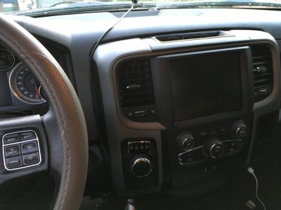

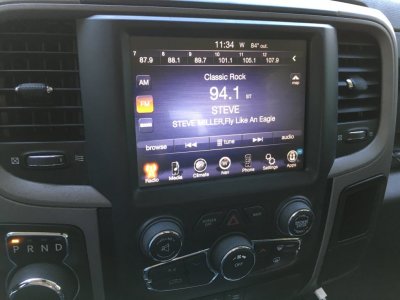

Upgraded 5.0 to 8.4 radio
Ramtruck16
Jan 14, 2018
147
31
Blue Springs Mo
I finally had a chance to upgrade my 5.0 radio to the 8.4 RA3 radio this weekend, thanks to mpgrimm(mike) for the quality fan harness, after i retrieved the radio code, i noticed that the Navigation has already been activated!! What a bonus, considering i got this radio so cheap just for the bigger screen..
i will be selling my original 5.0 uconnect radio if anyone is interested. I will make a post for it shortly.

My total cost breakdown is:
$275 for a RA3 radio from 14 cherokee
$85 for single zone climate panel from 16 Ram Bighorn
$175 for mpgrimms 7 speed fan harness and e911 bypass plug
$84 for the fan module from 17 ram bighorn
I have roughly $620 in total with my own labor.
Granted i could have bought a RA4 navigation radio for a little more but all i wanted was a bigger screen so the RA3 was fine for me and the price was right, it did have the navigation already activated which was a nice bonus..
