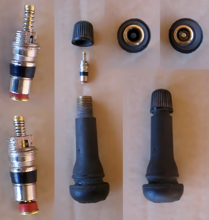

test port on the fuel rail is a schreider valve. I have used an old refrigerant gauge set to see pressure / relieve it off the fuel rail.
No schrader valve on a hemi's fuel rail
