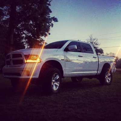

I have a 2013 ram 1500 sport that i recently installed a 6" zone suspension lift with bilsteins in front set at 2.1". The truck also has 2" wheel and hubcentric spacers granted they where bought off of amazon and probably are not the best spacers ever but all the specs are comparative to the expensive spacers as far as tensile strength on the studs and spacer material. When i get to around 45 mph the truck has a vibration that is just enough to aggravate the hell out of me. The more you pick up speed the worse it gets. The catch is is i dont really feel it in the steering wheel it is just the body of the truck vibrating. I know it could possible be a wheel out of balance but the vibration seems to be coming from the front and if it was a wheel it seems like you would feel it in the steering wheel. Could it be the front driveshaft and if so how can you tell and fix it.
