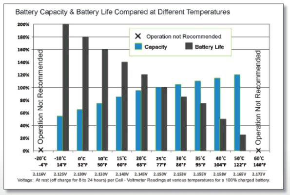

Sad. I have a 2024 RAM 2500. We have had some unusually cold weather this month, -40's. My battery failed after less than 12,000 miles and 17 months. Called the dealer in Fairbanks. I was shocked when they told me that RAM does not warranty the battery in Alaska, it's considered wear and tear. I haven't had time to check if that is true or not. Anybody know? Needless to say, it will not be a MOPAR battery replacing it.
Well yeah there is not much they can do, as you see in the chart the issue is you lose capacity in the cold and hemi's need more CCA then most vehicles. I would put a battery blanket on it and as much insulation as I could. I would be careful with a battery warmed blanket for the same reason on the chart, cold kills capacity and warm kills lifespan. Unless you have a battery warmer at 77f then I would avoid that.

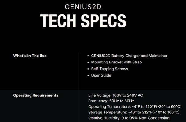

So Noco got back to me on this charger:
All of our GENIUS chargers, including the GENIUS2D, have a low end operating temperature of -20C (-4F). If the temperature is close to that, the units will not continue to charge as expected and may show their temperature error.
I have to ask them, next, if it will automatically recover from this error once the temp goes above -20C. EDIT their support says it will resume automatically.
That's good information to know, thanks. I don't know how I missed that limited low-end operational temperature value.
I will be careful to not recommend this device for people who live in cold climates and will be looking to find a replacement that functions below -20°C. During the past week, the temperatures here have dipped to -31°C (-23.8°F).
The block heater still worked and made starting quick and easy. I will try to get an underhood temperature reading during the next cold snap, with the block heater on. I felt the warmth when I opened the hood.
