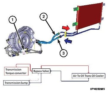

Transmission fluid (and eventually the transmission itself) longevity would definitely be affected if you ran 245 degrees often or for extended periods. 160 is considered the ideal trans fluid temp for optimum performance and longevity. That is the temp the trans cooler bypass valve opens and begins to flow to the cooler. Elevated temps every now and then under extreme circumstances will not hurt the transmission. Notice the chart above; normal operating temps can reach 284.
From Alldata:
The transmission oil cooling system contains a dual function bypass valve (1) between the transmission and the transmission oil cooler. The bypass valve (1) will bypass the transmission cooler when the fluid temperature is below 70°C (158°F) to aid the transmission fluid to reach operating temperature. The thermal bypass begins opening at 70°C (158°F) and begins allowing fluid flow to the transmission cooler, and is fully open when the transmission fluid temperature reaches 81°C (178°F).
