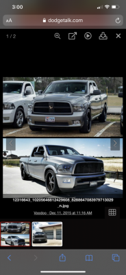

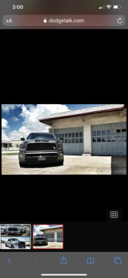

FYI: this truck is supposedly a bumper only swap. Meaning he didn’t go the grill and hood etc.
Just got an HD bumper and the little blank panels (for under each headlight) and made custom brackets for everything to line up.
it looks like it matches up real well with the 09-12 1500 grilles.

My guess is the 5th gen headlights alone would cost more than an entire 4th gen HD conversion lol.
I bet if there was a prefab kit to replicate the gray truck I posted above that it’d sell like hot cakes.
