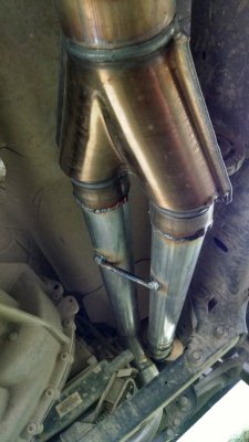

Any after pics of the new y-pipe installed? I wonder if a back yard mechanic could do this with some good band style clamps?
From the rear looking forward.
If you can cut the existing pipe, bend and flair new pipe, and clamp it in, go for it. The shade tree mechanic in me says no way. There are some pretty significant bends needed and there isn't much room. My shop pieced it together down where the old Y was to make it work.

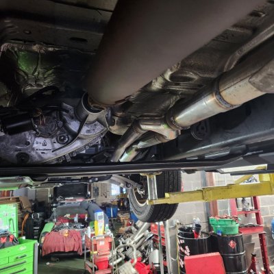

Mac's Custom Exhaust and Fabrication in Manassas Park, VA did a great job on this mod for my 2019 1500 Classic. They give veterans' discounts. Butt dyno estimates 10 whp / 10 tq. You can see (upside down) my passenger side pipe was almost completely crushed as compared to the driver's side (on right). Included pics of front to rear, rear oblique of install with Mac and his son Anthony, who is learning to weld from his dad. (I think that's awesome!) He got some practice on my pipe. For under $300.00, it's a great deal for ten more ponies, considering the price of the Magnaflow Y, and that they used 409 stainless.
