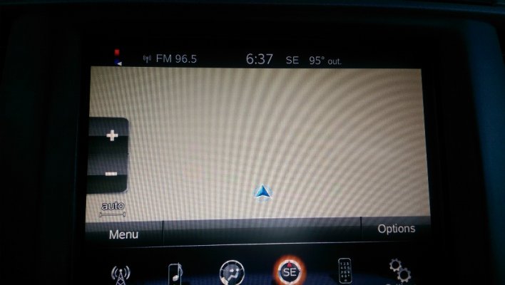

So I got my hands on a 8.4" VP4 CN, Chinese Version. I was able to unlock it and plug it in, however it does not seem to have XM radio and no US maps loaded. I wonder if I can flash the US firmware/maps to this and get it working.
Chinese? That's a new one! How did you come by that?
Maybe if you purchased the map update from FCA, but that's a big maybe. I don't know if it will overwrite the foreign DB. See my last post link. Maybe you could pull the USB switcharoo truck to get it to flash?

Not sure what you mean by that. Where can I get the latest firmware to flash to this?
This thread possibly, but you should first have a copy of firmware you know works on your radio. This could be risky, and could give you an 8.4B (B=brick).
