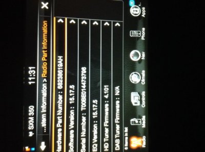

To others, please share your radio year & PN:
If you press and hold both the temperature-up (red arrow) and temperature-down (blue arrow) buttons at the same time, for 5 or so seconds, you are presented with the "Engineering Menu"

I can't confirm if the 8.4A (RA3) uses the same fw file as the 8.4AN (RA4).
What is your radio s part number?
( press hot+Cold+front defrost at the same time for 5s to get into dealer mode to see it)
If it in the fw file's part number list you may, may be able to use one of the fw files from the OP / post 4 at your own risk. (Ib would have to look issue the fw file for you)
Edit: I would first try reflashing the radio again with the FW you already downloaded onto the USB.
Sent from my LG G4 on Tapatalk.

Thanks for the response. Mine is part number 68238621AI.
I will try reflashing it again after work, barring it miraculously starts behaving.
