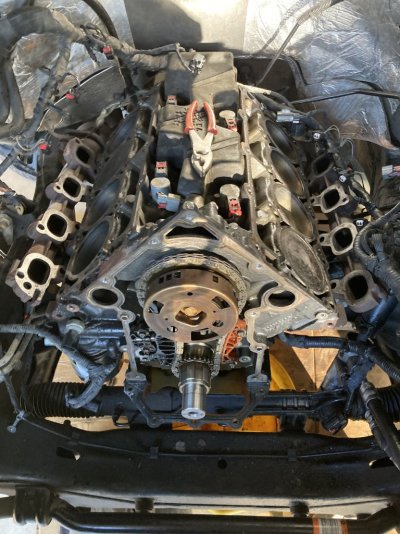

Thank you for the information
Dug right in and waiting for parts . Pretty easy job being my first time.
2 lifters were bad , cylinder’s 2 and 3
Needyourhelp
Needyourhelp
Feb 8, 2022
14
Usa
5.8 l
