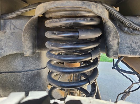

Ordered a set of Coil spring insulators from Eibach to get rid of the mickey mouse i fabricated as a test from vinyl tube couple of years ago. They're clear vinyl and between dirt and some mud from the trail they've seen they look like crap though still fully functional.

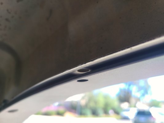

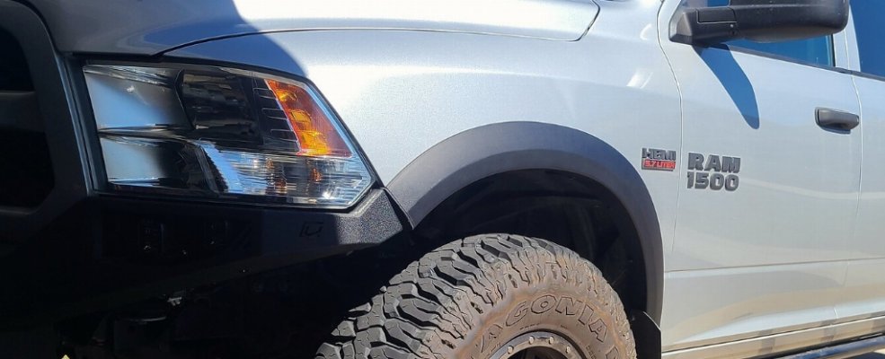

Got the flares installed. Didn't put chit in the back of them. I didn't want to make it complicated if i had to remove them. I think i like the end result. I'll need to do something about the headlight corners where i see a little portion of the bumper. I'll see if i can seal that off with plastic or something.

Out of curiosity, can you take a quick measurement and see how much discrepancy there is with the flares vs your origional heights. I know mine seem to sit a good bit lower than the origional fender lip. I wanna say it was almost a 1/4 different but I might be wrong.

The front seems about the same, if anything 1/8" lower just because that seems to be the plastic thickness.
39 1/2 front driver, 39 3/4 front passenger,
in the rear i have like 1/2" difference lower, 41" rear on both sides.

Made a couple of plugs for the flares in the front out of the same material i have in my mud flaps. Bolted them in by the edges with double side tape.
