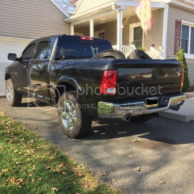

Good move on the Bils. Here is mine set at 2.1 in the front with 2" spacer, polyurethane, in the rear. You want that in the rear, if you choose to, for no noise. Hope this helps and as stated, mevotechs are on mine too. When I took off the UCA I was mad because the were so inferior to the mevotechs, which can be greased. You are gonna have the front end apart anyway so why not just do it all at once

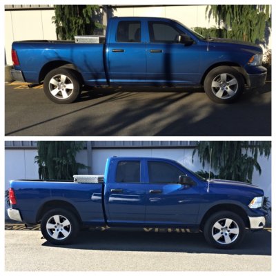

Do it. Mine is a 2010 so no balljoint issues but I have them set at 2.8 with a 1" spacer in the rear. Rides better than stock and no vibration.
Before and after

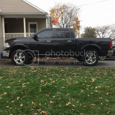

I'm at 2.8" front with a 3/4" rear poly spacer. No issues.

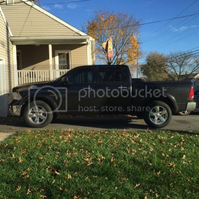

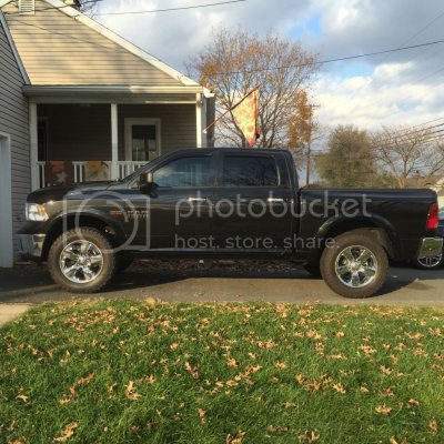

Alright. Sorry for the long delay in putting up the final results. Things had been really hectic for a while. I did get the lift on that weekend and then had it aligned later in the week. Truck rides and looks awesome! Thanks for all the info! Now for more mods....
Before:
After with stock tires:
After with BFG All Terrain TA KO2's in 285/65/20:

Bils set at 2.8" and 1" TGC spacer in the rear. I just measured it the other day and it settled at 40.25" to the top of the wheel well in the front and 41.25" in the rear.

I'm fairly certain 35's would definitely fit. Not sure on how wide though. These are 34.6" x 11.2" and I have plenty of clearance.
