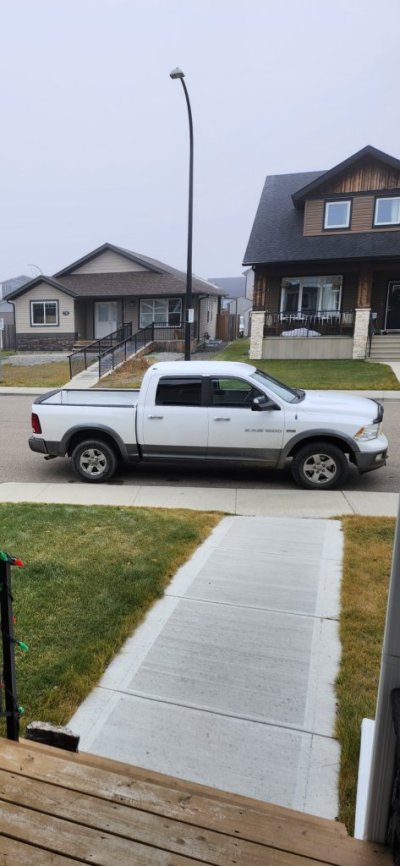

Try driving the truck with eco mode disabled this allows all 8 cylinders to run all the time and not be affected by mds.
MDS will eventually ruin your lifters and your cam lobes over time. I've got a 2012 outdoorsman 5.7 with 310k kms still going strong
