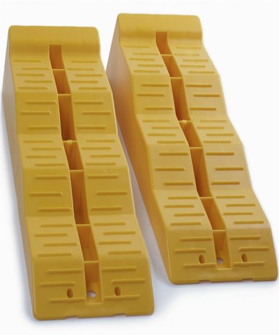

Make sure you jack the rear of the truck up,till the pan rail is level front to back and side to side when you do your final fluid level check.The instructions that came with my brand new ZF 8 speed are very specific about having the pan rail level,it's the only part of the instructions that are actually high lighted.Most video's don't show the truck being jacked up to level the pan,but it's probably wise to do so.
Burla
Apr 28, 2012
27,545
57,761
2010 Hemi Reg Cab 4x4
does it ride or sit level? or you have to jack up one side to achieve level? maybe the mutli position ramp can help?
Jan 17, 2016
23,720
54,467
14 Sport
They'd be a little short Burla.To get my pan rail level when I replaced my 8 speed,i had to jack the rear of the truck up,so the bumper was a probably close to 4ft in the air.It took my tallest set of 6 ton jack stands on their highest setting ,set ahead of the rear locating arm mounts to get the pan rail level
so how do they do it in the dealer when they only use a lift and the mechanic is under the truck working
Raylan Givens
Dec 28, 2018
33
18
US
2017 1500 Crew
I am just thinking, if 7 - 9 quarts comes out, make sure the same amount goes back in. If that requires lifting the rear to do it, so be it.
Jan 17, 2016
23,720
54,467
14 Sport
Very few dealers are familiar with servicing the 8 speeds.Pick a facebook page like Tuned Rams or High Preformance Rams,and i'll post the instructions that came with my tranny,and they are very specific about getting it level.The only part of the instructions that are high lighted and capitalized is the part about leveling the tranny rail,so apparently ZF and FCA figure it's pretty important to level the tranny pan rail,lol
