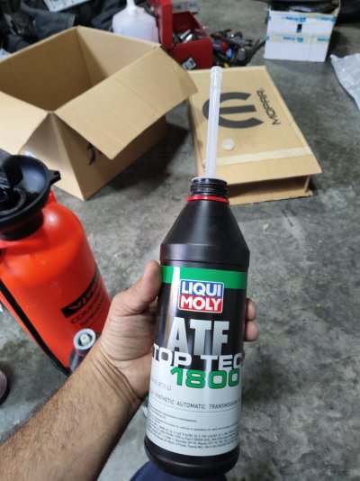

105400 kms, 1500hrs, 20000kms with some sort of trailer in a hair over 2 years. Bought the pan and fluid on the first big rock auto order after buying the truck.

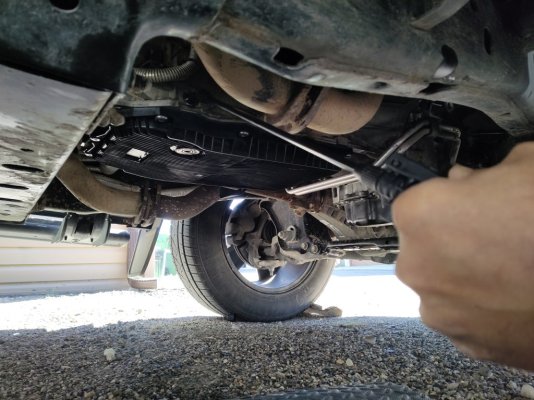

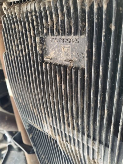

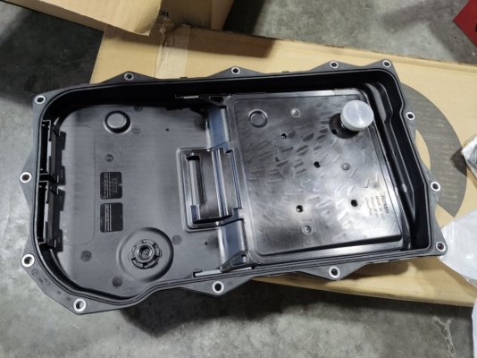

Old pan. No drain. Messy.

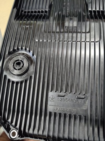

New pan. This will make a drain and fill in 10000kms easy.

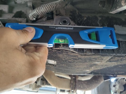

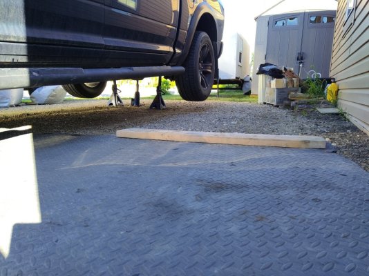

Level enough.

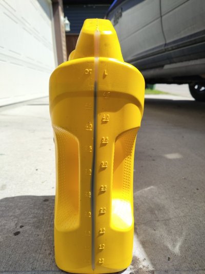

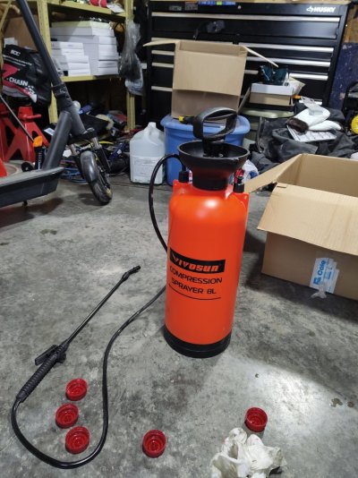

This made filling very easy.
Why can't gear oil bottles have this!

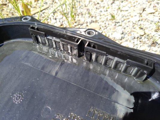

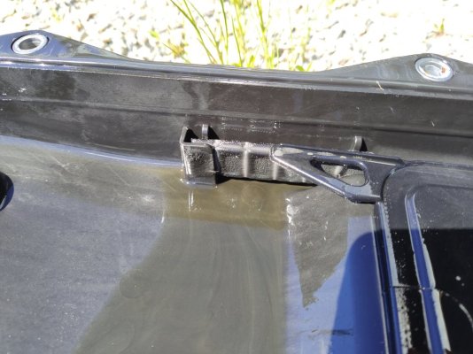

Fluff on the magnets.
