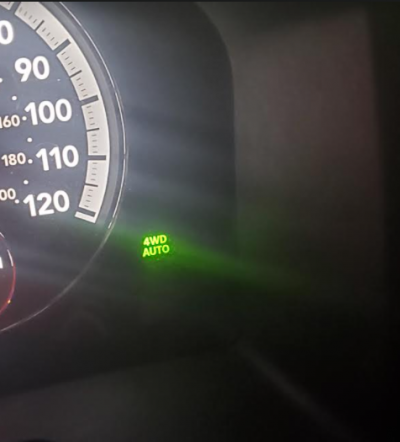

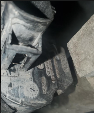

La_paipa
Jan 4, 2022
Kanasas City
Man, I got the same problem on my 2011; no lights at all, no service light either. The 4x4 sometimes works but not when I really need it to work. Tonight I got under and unplugged the wire going to the transfer case actuator and sprayed the plug and receptacle with contact cleaner and the 4WD Auto worked a couple of times but then it quit. How can you tell if its the actual Actuator that is bad?
