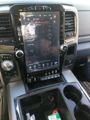

I sent some stuff over to Roman217 for him to try out, but we’re chipping away at it.

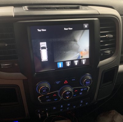

@Jimmy07 Thanks for sending me the CVPMs to test with.
The good news, the Pacifica CVPM does show up on the RA4 but the soft keys don't work but I didn't expect them to.
So the 360 degree view would work though I was not able to get he grid lines to show up for the rearview camera but I did pretty limited testing with it. I am also testing with a 2015 RA4 so maybe the 2016+ plus RA4s would have better luck.

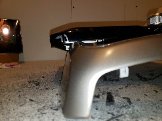

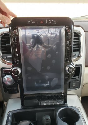

We'll, the screen can definitely be convinced to fit the 4th gen center with only a little bit of overhang at the top.
Still a ton of work left to do to make it complete but I got the cuts made to get it to fit into the bezel. There is still a lot of fine tuning that needs to happen.

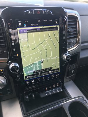

I think if I did this again I would have my screen up a bit higher
Less cutting of other materials in truck
