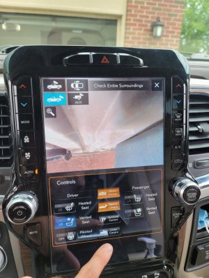

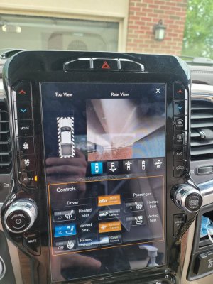

A bit more progress .
Still waiting on last mirror to come in .
The front view shows the parking sensors as well .
Had to add another can module to convert a message .
Thanks for helping me with that Roman .
Will keep pushing to get this working .
I finally got my other mirror in and installed .
I can’t get the side and rear cameras to Calibrate still .
I did try a diagnostic session with my cvpm and some direction from Roman and got the 360 to work for this key cycle .
I will try and get my cvpm calibrated in a Pacifica some week here and then throw it back in the truck .
This is just a short term solution hopefully as getting Hold of a Pacifica might not be Easy for others etc

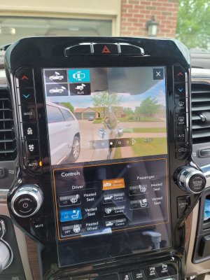

Made a lot of progress on the surround view! My truck looks like a bomb went off right now but it all looks to be working. Even the trailer cameras will work, just need to actually have some hooked up and run the wiring for them.
Whats left:
  • Mount the front and rear cameras
  • Run the calibration
  • Need to check my CHMSL camera cable since that doesn't seem to be working
  • Finalize the HVAC translation module
  • Figure out exactly what all is needed to get the radio to behave as I have a ton of stuff being spoofed right now.

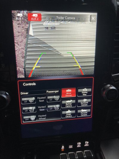

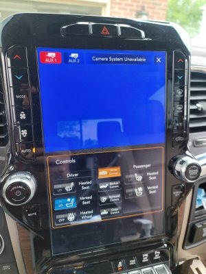

So I thought I would add this to this thread .

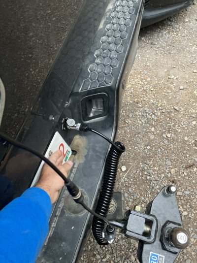

I’m currently in the process of adding aux camera to my travel trailer
All of the parts I got off Amazon .
Except i had m2 mods rca pigtail from a project before .
All the truck side wiring is done .
I just need to run the 4 pin cable to the rear of the trailer still .

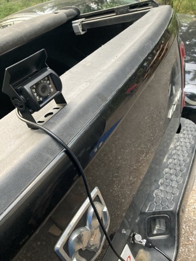

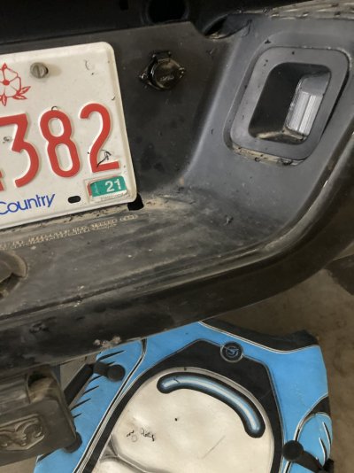

Here is a pic of the camera just sitting on the top of my tail gate .
I had to drill a half inch hole for the
Bumper connector .
Here are the parts I have bought so far .
The main trailer wiring kit I got is used for one camera only but they have the same setup for 2 cameras as well .
Thanks again to Roman for getting the aux cameras and 360
Working for us .

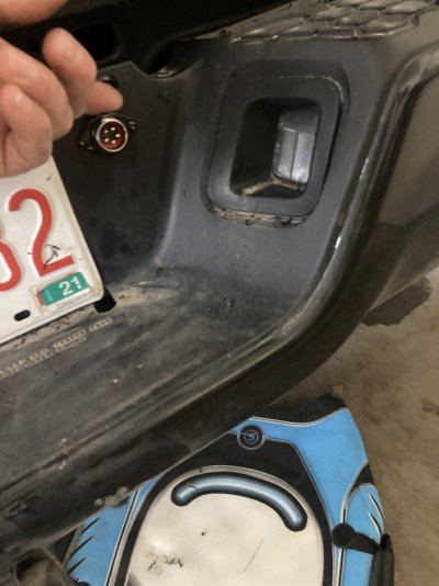

Here is a pic of the connector installed on the bumper .
The connector comes in a chrome color so I just spray painted it black with some marine black spray paint .
I will add to this thread of which pins the aux cameras getting pinned into the radio .
