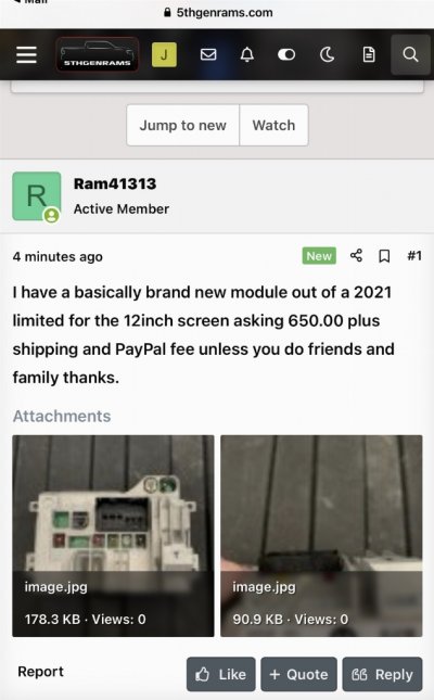

This one just popped up a few minutes ago on the other forum (won’t let me link it here)- V1l7icU.jpg
