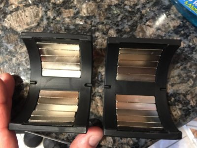

I would use it as well...personally just switched to redline....but I used 4 quarts 5w-30 and 3.25 5w-20....down the road I will change over completely to 5w-30 as well. If it makes you more comfortable order a couple qts of 5w-20'and mix em. This oil has quieted my truck down already in less than 400 miles...I second the royal purple filter as well...for added protection instLl a filtermag.
I'm liking the idea of the filtermag, do you have a PN on that?

Hemi 5.7l
Burla, I'm curious about something that some on the forum have said. Does using 30 instead of 20 actually have any effect on MDS?
Also many are running 5w-30 without any problems at all with mds...I am running about 5w-27 with my mix of 20 and 30. The manual states you can run 5w-30 if needed.
