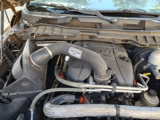

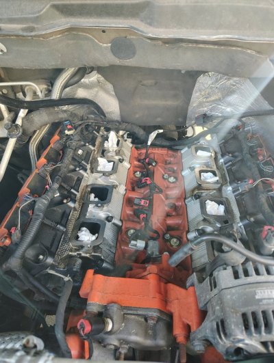

After 3 years, I finally purchased and was able to install the 6.4L truck intake on my non MDS 6.4L Hemi.
Not exactly a plug and play but easier than one might think.
So the MAP sensor is different but it is exchangeable from one to the other (you must trim the tap at the back of the manifold).
The harness that was acquired from MMX made the SLR hook up very nice and clean.
A very nice S&B filter and CAI for a 2500 bolted right up and made the connection nice and clean.
I still need some tune adjustments but it runs very well.
