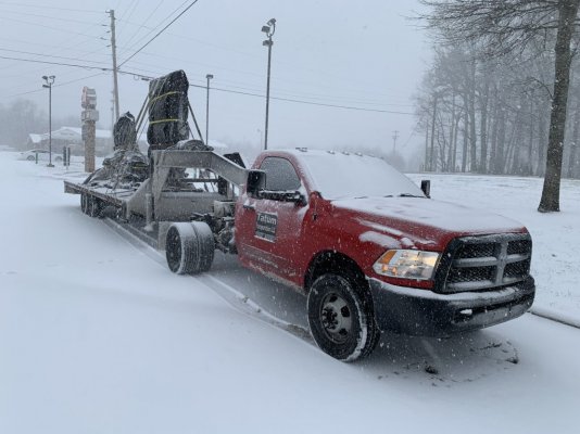

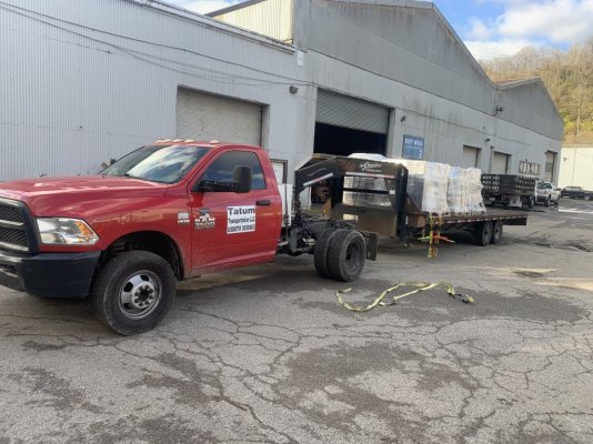

I’ve got a 2017 Dodge Ram 3500 Reg cab dually 4x4 with 4.10 rearend. I hotshot for a livin, so I do a **** ton of driving. Currently truck has 240k and runnin like a top. At 93k engine went due to lifter lock up on cylinder #8, sent metal shavings through the whole engine, so got a brand new long block dropped in courtesy of Chrystler.
Other then that, no issues At all. Stock tranny. Stock rearend. Stock front end. Just routine wear items.

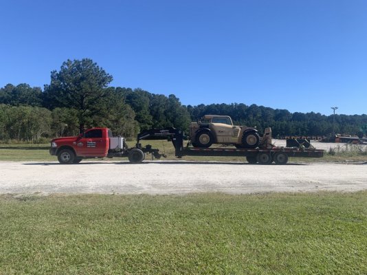

But eventually, I know this tranny will fail. Last year I did 107k miles. And although these HDs are badass, they are not semis. 90-100k a year every year with every single mile hooked to a gooseneck takes it toll. I do religious maintenance. Tranny flushes with fluid changes and filter changes, diff fluid changes (front and rear) , oil changes and oil analysed, ect ect ect. My question is, when this tranny goes, could I go back with an AS66RC (Aisin) tranny instead of another 66RFE?

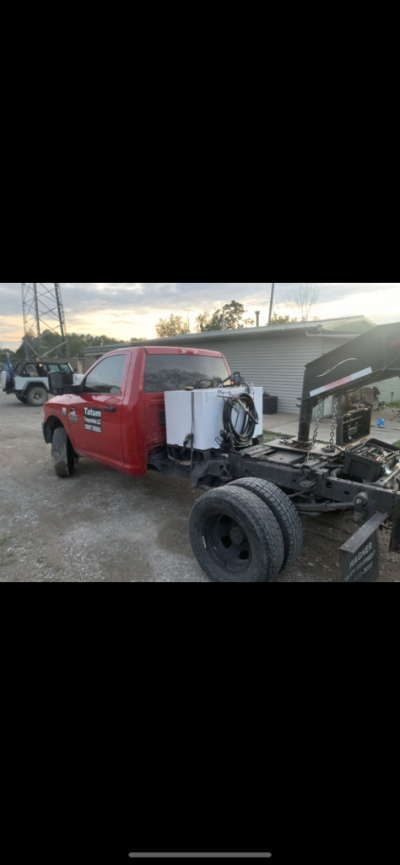

I know they offer them in C&C trucks, mines a regular 3500 pickup that I’ve pulled the bed and stripped down to C&C style. Just curious. If the Aisin swap is not possible, I’ll be going back with a factory OEM 66RFE. I’ve got buddies that have trannies go and they always go “built/aftermarket” ****. I’ve seen them deal with more failures with that then I care to mess with. I mean, I’m not a smart man, but I know OEM can handle 240k of abuse, idk what some “aftermarket” **** can do lol.
But just curious if anyone has done this/ has knowledge of if it’s possible.
