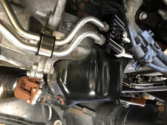

No, this is in the oil line to the cooler radiator in front of the truck. RevMax Transmission Cooler ByPass Housing Installed.jpegRevMax Transmission Thermostat Housing Replacement.jpeg
Here's pictures of the RevMax straight-thru retrofit housing I replaced the OEM thermostat housing with. ATS also makes this housing.

Yes, That thermostat will get plugged with clutch debris and cause the temps to go up and most don't notice until it's too late.

And the thermostats aren't reliable, either. Members report being stuck closed. I suppose they're made in China. Add to that the orifice for the thermostat is much smaller than the cooling line, and you have restricted trans oil flow even when the thermostat is open. What a complete Rube Goldberg Kluge of a concept & design!! I spent 32 years in Design Engineering.

I replaced the trans thermostat block with the ats unit and all is well. No issues and notably cooler trans temps.

Sure. Here it is right from ATS.
However, if I had to do it again, I'd get the one @HEMIMANN got. The 66rfe has all hard trans cooler lines, unlike the 68rfe. The ats one is designed for the 68rfe and i had challenges getting the lines to bolt up. When I questioned it, i was told my transmission had an uncommon OEM thermostat block?
I got it hooked up and all is well. Also the, metal filter nipple they give you with their kit (the whole reason I bought the one from ats) was cut wrong and would not thread into my transmission. So unfortunately I had to use the OEM plastic one when I serviced my transmission. Ats customer service said they'd send me a replacement, but never did.

Can't say for sure, but I had to force the hard steel lines a bit to get them to line up with the openings in the bypass block. I also had to put threadseal on the lines threads because I had an oh so slight drip from one of the lines.
I also had to tighten them more than I'd have liked and struggled to get the lines back into their retaining brackets, more than I should have had to do in my opinion.
I didnt have issues like hemiman, but it was a bit challenging, more than the ats install video on the 68rfe with two of the lines that are soft and easy to manipulate. Hemi did not report any of those issues with his rev max block
Good call on the bypass you ordered. I just wasn't overall impressed with the quality of the ats block and customer service. Just my opinion
