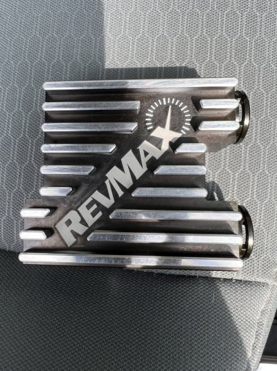

Looks and feels like a nice quality part but not sure why they have offset holes like this. CB1316D3-D9EC-4BA8-92B3-D54D047EC004.jpeg3FB883D6-AC85-40D9-8A5E-C5CC35A12872.jpeg

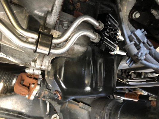

Huh. I don't remember that. Maybe it fits better? Here's what mine looks like...RevMax Transmission Thermostat Housing Replacement.jpegRevMax Transmission Cooler ByPass Housing Installed.jpeg
One side is offset not both like yours.

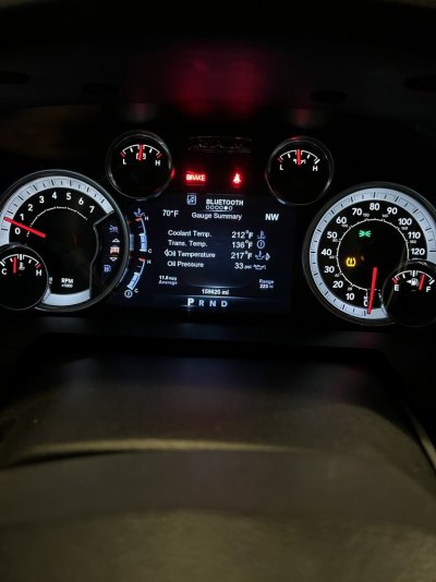

Installed. So far have not seen temps reach above 136 on a 40 min test drive down the freeway. Only reached 100 on my 15 min drive to work this morning.
Install was a little bit of a challenge do to my own error. Lost 4qts of fluid do to me not installing the orings inside of the block. Didn’t figure this out until I had it put together and started the truck so I could check for leaks. No idea why they would ship it without putting them into the block but lit was my fault for not checking it first. Should have only lost half of that fluid.
