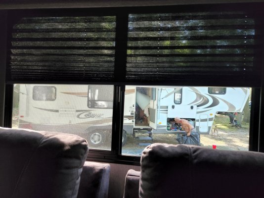

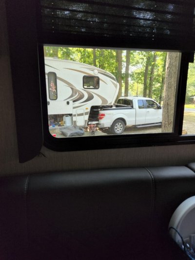

Here's the perfect example of over weight. This just pulled in next to us. Four people in the truck plus at least two tires and a propane bottle in the bed. It's an F-150 Lariat
Hope he trades it before he needs a transmission.
I also bet he made good time getting there going 75MPH down the highway :D
