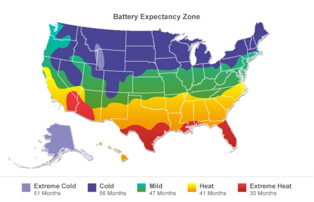

In Florida the Lithium will probably work fine. In Canada during the winter, they suck.
As far as AGM, Regualr Lead acid last about 10 years here. I cannot see an AGM lasting enough longer to be worth 65% more new, it would have to last 17 years. If you look at the warranty, full replacement for 48 on Lead Acid, 60 on AGM, both prorated after the full replacement to 100 months.
In Florida, the heat is what kills batteries, it kills AGMs nearly as fast as it kills lead acid, so why pay the AGM premium.
In Florida, the heat is what kills batteries, it kills AGMs just as fast as it kills lead acid, so why pay the AGM premium.
Searching Batteries For 2021 Ram 2500 V8 6.4L Gas​
Showing 2 Results
Good point about the heat/cold problem, I grew up in North Dakota, specifically right along the northern edge so I understand the issues of battery lol. That being said your comparing a expensive name to a Costco house brand. I bought my agm batteries on amazon, they were $150 each
Showing 2 Results
I understand that heat can have negative effects.
However, the last two factory batteries lasted for 9 years in my 2004 , then 8 years for my 2014.
The 04 , was a construction use vehicle, it would be driven short distances,and shut off and restarted dozens of times a day .
In between it might have sat with the radio cranked for a couple hours.
I live in south fl. It is summer year round.
I was born in Pa., where it seemed like every 2 or 3 years was time for a new battery.
Maybe I have just been lucky enough to get one of those batteries that was properly assembled ?
Every time I see these temperature charts , I have to question the accuracy.
But my wife buys Asian cars , for higher mpg.
These tend to eat batteries for me.
If I get two years I feel like that’s about the best I’ll get.

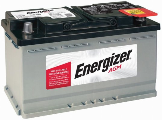

I agree, costco has top notch stuff, most of it is likely made right alongside top name stuff just without that brand name. I don't challenge your solution in the least, I was just pointing out costco brand stuff will be cheaper no matter what. you could get agm for less then that energizer brand though. if costco carries one even better.
Sorry, I mis-understood your post. The Energizer AGM I posted above is the Costco AGM battery listed for my pickup and the $329.99 price is the Costco price. Costco sells Energizer and Kirkland here, the Kirkland batteries are made by Energizer.
