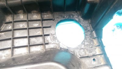

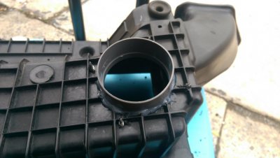

It ain't pretty but works lol

Is that 3" or 4"

I've tried vararam and s&b and I'm sure this would have to work better. When air gets ram in the air box it has nowhere else to go. I have a aem dryflow filter
