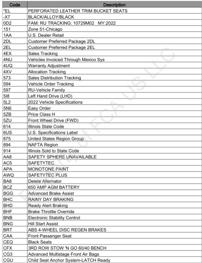

Those sound like option codes. If you can get the option code sheet for your VIN, that may help. Here is an example...
EDIT: Google something like "option code 5zs chrysler" to find the codes you see
Thanks for the tip. I found a Chrysler options list. If I go by that, I have a 5ZR - 4 doors. SDU - Heavy Duty Suspension with W/Gas Shocks. BR6 - Anti-Lock 4-Wheel Disc HD Brakes. DSE - Tru-Lok Front & Rear Axles.
I don't know if that's true. But I definitely have four doors and larger brake discs than the older models. I don't know anything about the axles, but I don't think those parameters have any impact. Is there anything I need to pay attention to or other control units I need to check?
The only way to know exactly what you have (without physically examining part numbers) would be to get that option sheet for your VIN. As you can see by the watermark, it's not necessarily something the customer is meant to have. I had a source that could get me this but I haven't seen them around in a long time.
Being in Germany, I'm not sure if you have dealerships but you could always ask them for that information or pay them to flash that factory option list back to your vehicle.
EDIT: PM me your VIN and I'll reach out to them to see if they can help
