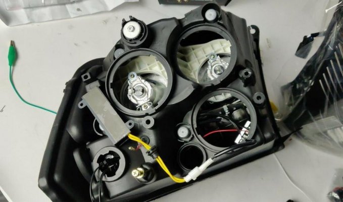

Trust me, I know it's not easy. the oem projectors where my first time opening a set up. Took about 40 minutes on the first and and 20 on the second headlight.

I've opened both oem projectors and alpharex g1) Alpharex definitely open easier. As far as quality of the housing and lense, in my opinion seemed fairy close. The clarity of the alpharex g1 projector I feel are better than oem. Oem uses a blue/purple tint on the lenses. I forget the reason behind it. But I like the bi functionality of oem (partially why I retrofitted mine). Although oem uses a supplemental high beam also.
In my opinion, as far as "cheap" aftermarket headlights are concerned, alpharex are on the top end. They have their own flaws but without having a 09-12 version and a 13-18 version (wiring capability for turn/park errors) they are a great option.

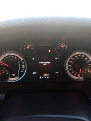

As anyone figured out the park light out error on the dashboard.View attachment 217243
Working on a solution with tech support. I've got mine now so it'll only throw that code when the light switch is set to the marker light setting. I do not have DRLs set on my 16. And I do not have the drl box installed either.
I would like to know also, I also have a 16. I’m running alpharex pro g2’s. I’ve been through every setting in alfaobd a million times and no matter what I do I still get a park light out error on my evic. I can use my park lights/headlights/fog lights with zero issues. I can use my turn signals with zero issues. BUT if I have my park lights/headlights and park lights on and try and use my turn signals PARKING LIGHT OUT!!!!

Well surprisingly enough Alpharex support has been great with me the last few days ... I am probably going to end up getting the 09-18 Ram Truck PRO-Series (5th Gen 2500 Style) Projector Headlights Alpha-Black ....
I am just trying to decide which LEDs to use .... I was going to get the LUXX series which have the built in leds but if they burn out they can not be replaced ... I rather have something I can replace the LEDs in and look exactly the same ...

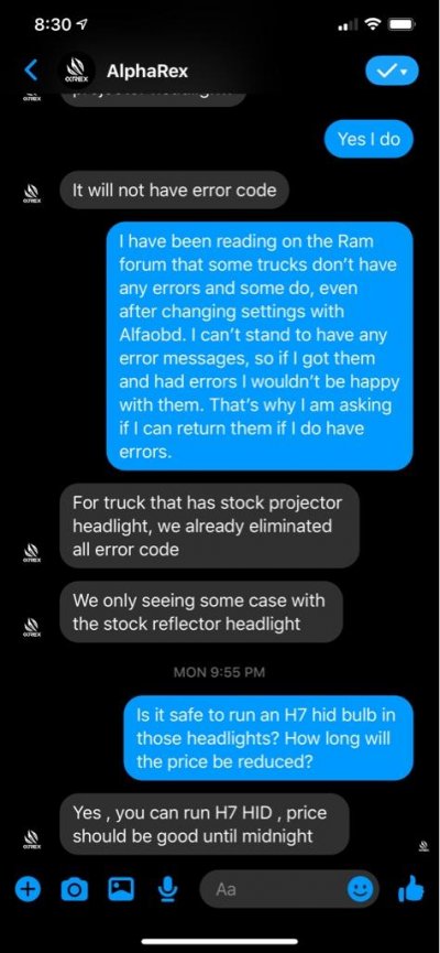

To the ones having problems with bulb out messages, do you have factory projectors or the reflectors? I have messaging Alpharex on Facebook and they assure me they have all the issues worked out on the trucks with factory projectors.
Factory quads here . I have been working with a guy in tech because apparently there are quite a few having issues and the last guy they sent resistors out to never reported back so they don’t know if they fixed the issue or not. I told them I would try it and report back but it sounds like their goal is to make a revision to the built in load resistors that they use in favor of one with a slightly different threshold . 2162ff8a521410124e82a113e7417ec1.jpg
