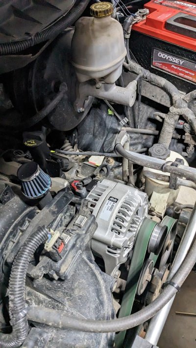

I put in the 6.4L 220amp alternator :anitoof: and an H8 Odyssey battery. Never had issues ever since winching on the trail, while my Alpine 1000w class D amp is pushing the two 12" Type R's.

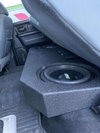

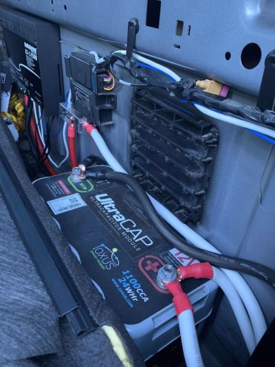

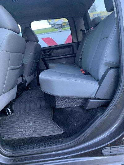

You can try an ultra cap. Not cheap but cheaper than a new alternator. I'm running a total of about 4k watts (peak). 3400 to the subs and 600 to the 4 door speakers. I'm looking at a 400amp alternator when I decide to replace the stock one. I wish I had more but I didn't want to lose seating. I got lucky, the ultra cap just fit behind the seats in my 2500 crew cab.
