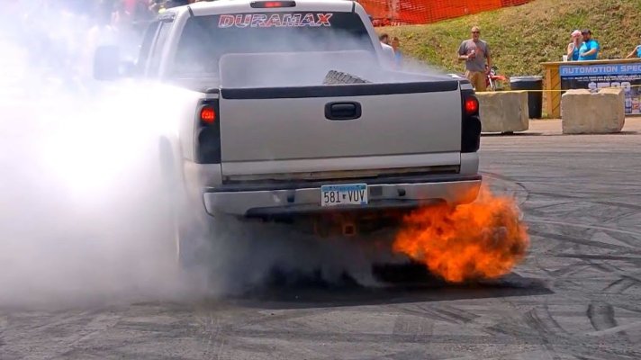

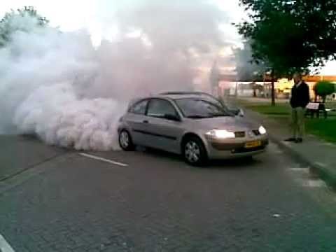

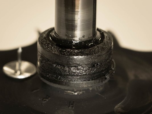

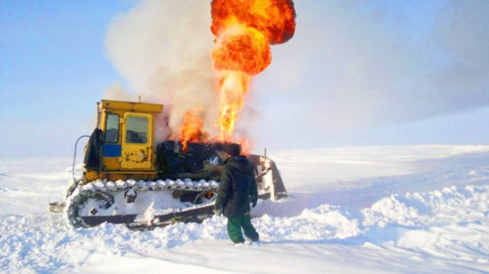

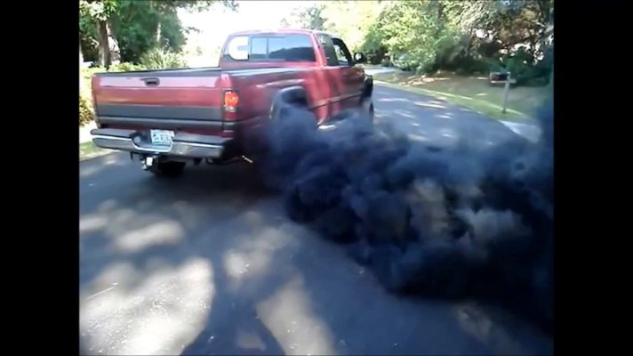

sorry you had great luck thank god. even cars do it. had 4 at condit ford at night, county plow trucks, two times on a rental fleet motorhomes, out of state $$ had to get them home with the renters. can't screw with peoples vacation. no diesels or turbos on rental motorhomes. a * i have a diesel tractor with a turbo, they all s**k when they break. they didn't pay me to purchase it, Y wave the flag. we have a 28000 + or - customer base i have seen to much. i have seen sales people pulled over the counter and see god for a truck that didn't do its job as stated. i love all units when they work. a motorhome renter is not a owner operator they push the pedal down and go. that's what they paid for to go on vacation, not check anything but the beer,food,kids and how much they are going to get that night. got to go the phone and email calls. be safe.

I'm intimately familiar with runaways, and have seen my fair share of them but most were on older platforms. I can count on one hand the number of runaways on newer engines. The systems are designed to prevent it by shutting down the fuel to the engine. None of the newer engines employ mechanical fuel systems. Mind you... we are talking about light/medium duty diesel engines... not a Detroit 60 series, a Cummins ISX, CAT C15, etc...
That cateye Chevy truck in the 3rd picture is on a burnout pad participating in a burnout contest. That is not a stock truck by any stretch, so shouldn't be in the conversation. The Ram is a 2nd gen so it should have the old 5.9 12-valve. That is extremely old technology by today's standards. It runs a mechanical fuel pump.
I'm not saying it doesn't happen. I'm saying it isn't applicable to today's conversation. Neither is turbo life expectancy. The reliability on both is there.
