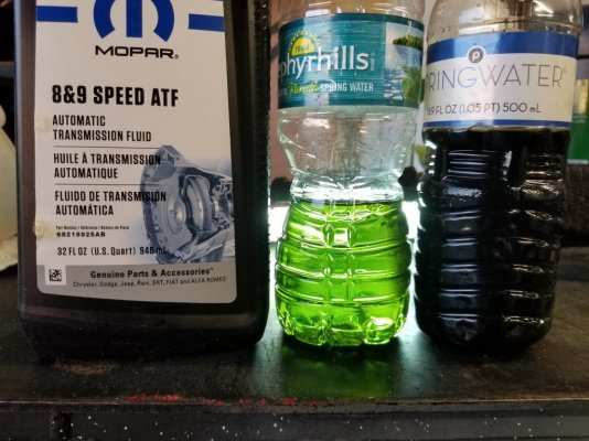

Heres what my 8spd fluid looked like at 108k miles:

2014 dodge ram 1500 8 speed trany, change my fluid last summer 184000 km ,original fluid and it was black ,replaced the tranny pan with a dorman replacement that has removalable filter. It seemed to shift and run smoother, attached is the procedure i used, and a shot of the black fluid that was drained, drained 4/12 liters and added the same.
