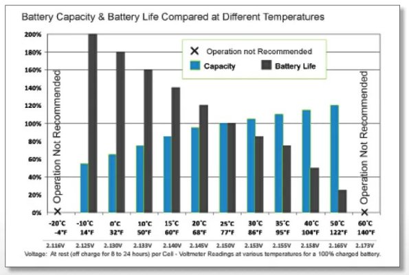

Look at parasitic loss. If the battery lives in SD the capacity now in year 7 is low, could be the issue. Hemi's need a lot of amps to start, if the capacity os like 1/2 of what it is new, the truck aint gonna start. But the fact you say dead, could be draining somewhere. Regalrdless, it is time for a new battery if it is 7 years old. a 2018 would have been built 2017, and now it is 2024, well over average span of 5 years.
