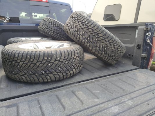

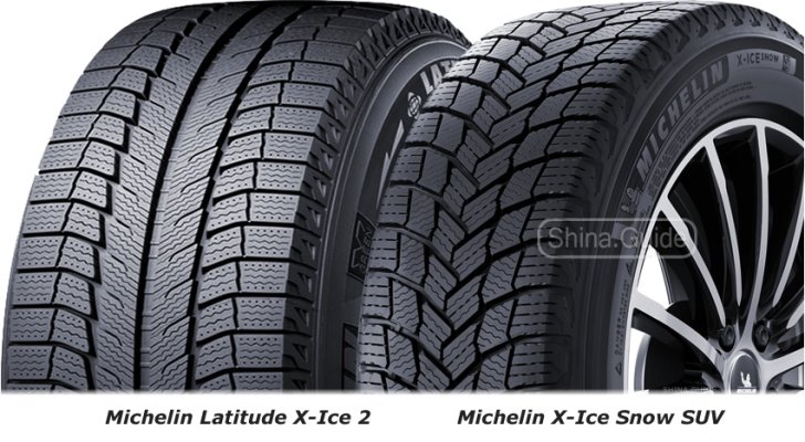

My 2 cents, I run summer, Pirelli Scorpions and winter tires, Michelin SUV X-Ice, on my wife's Grand Cherokee, both on 20" factory rims. It never goes off paved roads and is mostly driven in town. True winter tires are a much softer compound that stays soft in the cold and have better grip on pavement, snow, ice etc particularly at 0F and colder. What they are NOT great at is deep snow or mud of any kind, as they do not have large tread blocks with large openings. Those smaller tread blocks are why they are quiet and work so well stopping, turning and accelerating on ice, they have more rubber and many more sipes touching hte ground.
For mud, deep snow, unpaved roads, the 3 Peak AT tires are a better choice. They are softer compound than a regular AT, thus will wear sooner, but provide better on road wet, ice and light snow traction in cold weather than the harder AT compounds that last longer. You cannot get long tread life and really good winter traction from the same tire. The compound needed for good winter traction is incompatible with the hard rubber needed for long tread life.

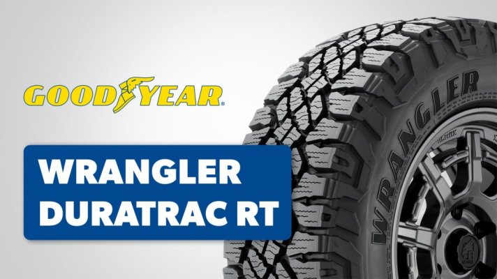

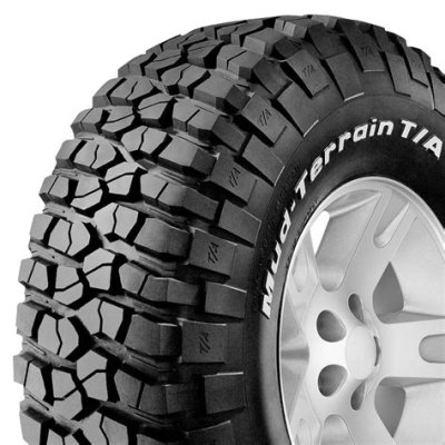

Tire choice gets debated here endlessly, but the truth of the matter is, the right tire for the specific use is actually pretty easy to pick. Bigger tread blocks, softer rubber, better rock, mud deep snow, think Mud Terrains and similar designed tires. If it has lots of sipes like a Duratrac, will work decent on road too. I sipe my Mud Terrains to improve on road and winter use.
Best winter pavement and good gravel, quietest, has small tread blocks, real soft winter compound, a ton of sipes. So Michelin X-Ice, Hakipilatas etc. Deep snow, mud, you need biiger tread blocks. I run Mud Terrains or Duratracs on my PUs and off road rigs.
BF Goodrich Mud Terrain

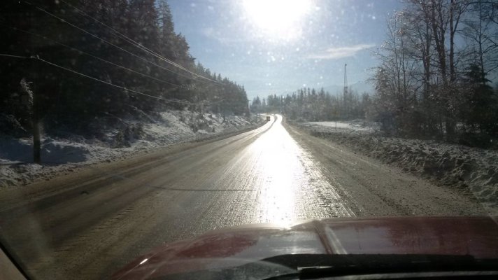

Exactly it. So here in Southern Ontario the roads are mostly dry and winter hovers just around freezing, only a few colder weeks in Feb. We get dumped on by lake effect snow and all he|| brakes lose as the roads get snowed over and greasy, but then they dry up and it's just pavement again for a while. I've never had trouble controlling my truck on the dry roads where a true studless winter tire would shine. I need better control over the deeper snow and greasy stuff and IMHO a 3 peak AT tire should handle this very well and a dedicated winter with short grooves would just sled over the greasy stuff as it can't eject it out fast enough.
