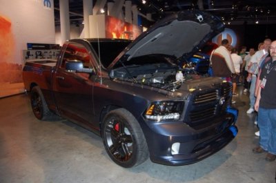

Anybody go to SEMA this year?
What did this Ram have in it?
