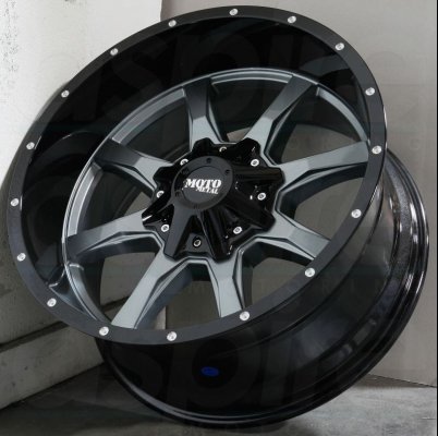

Well, I decided to just bite the bullet and deal with the MPG. Hey, it's a truck after all. I have ordered 20x9 Gray Black Wheel Moto Metal MO970 with LT285/60R20 Mickey Thompson Baja Boss A/T All Terrain. Should be here in about 2 weeks from Custom Offsets. I will post pics once they are on the truck. Thank you again!!
