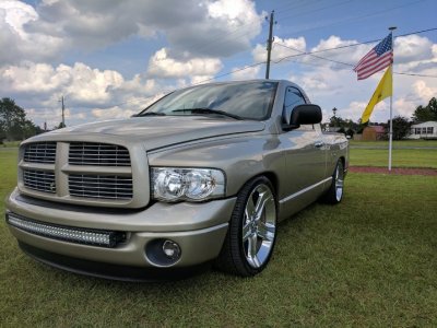

Here she is bone stock picture vs. now.

so whats the difference from stock to now, i cant see it, lol!
Just kidding man you know i love your truck!

I took the tool box out of the bed and added a light bar. That's about it.
yeah, i just did a few paint touch ups and cleaned my wheels on mine :roflsquared:

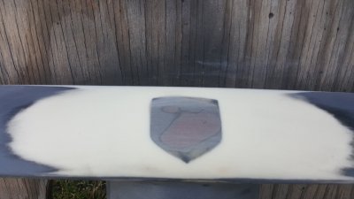

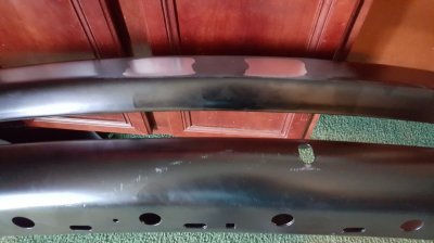

Did you paint right over the chrome? Kuz I know the chrome on these grills don't come off for sh☆t, or did you buy a unfinished one?
I bought a primered shell, it was really cheap. Then I filled and shaved the emblem.
I did the same thing with the bumper, just bought a primered one and then I welded the license plate frame holes shut and smoothed them.
nice. yeah i was planning on just sanding the chrome off mine then painting until i found out the hard way that crap dont come off lol. found unfinished plastic shell so buying that, driving around lookin a bit ghetto in the mean time ha

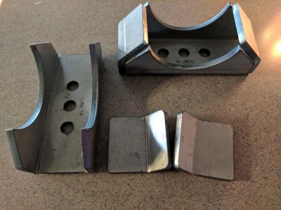

#3: New leaf spring perches. Already ordered. I'm a bit **** about doing things correctly and with approximately 12" of drop, the pinion angle is jacked up which can cause vibrations and premature u-joint failures. I have been lucky and haven't had these problems yet, but I'm going to remove the McGaughy's flip kit, cut off the factory perches and have these new perches welded on at ride height with a good pinion angle.

The new spring perches arrived today. These things are some serious overkill for my application, but anything worth doing is worth overdoing, right?
