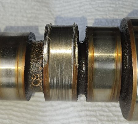

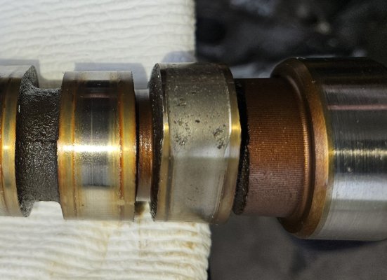

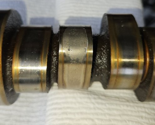

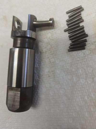

On the downside (hopefully) of my cam/lifter failure, 2015 SLT 201,000 miles.
Everybody talks about the needle bearings failing, causing the redesign, but my needles were fine. It was the PIN the needles roll on that failed for me.
And, alot of people say MDS is the issue. My failure was a non-MDS lifter. #5 Intake lifter.
Also, both of my #8 (also non-MDS lifters) cam lobes were starting to wear, the lifter rollers were fine, as far as I can tell. #5 Intake cam lobe:
#8 cam lobes, wear just starting.
I think there are several factors at play. Oiling, and maybe less than adequate heat treat on the cam and lifter pins, maybe?
Any part can break at any time, fix it and go forward.
