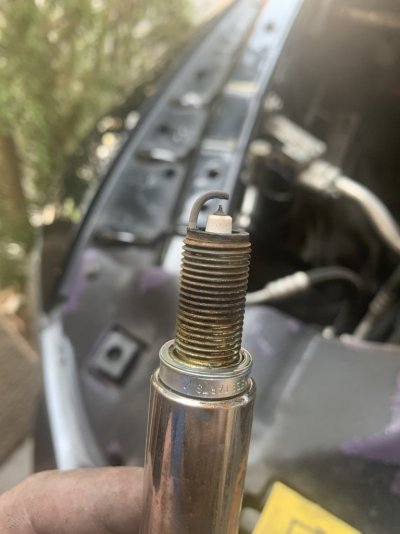

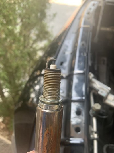

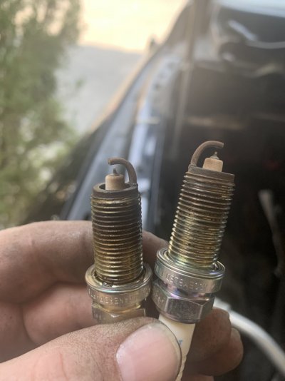

Swapped coil and plugs to cylinder 2 from 6……. Drove 50 feet and P0306 immediately came up. It’s not looking good for me. The pics of the single plugs both came from cylinder 6. The 2 plugs in one pic were out of cylinder 2.
Always full synthetic from brand new and always 91 or 93 octane whatever was available to me.

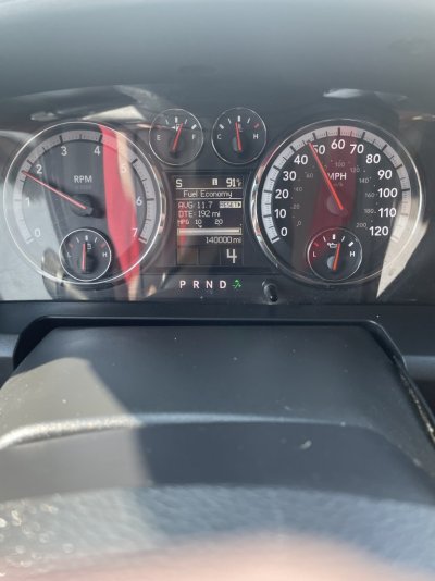

2009 1500 5.7l. Cam seems to be wiped out. Misfire on cyl 1 after 4K rpms. Owned the truck since 130k about 6 months now. Started at about 135k miles. Now at 140k. I have little tick sounds like from my exhaust manifold but doesn’t seem to be seized lifter. Kinda annoyed and just fed up with the pos at this point.
