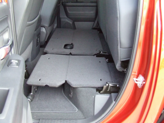

I do not know about how you use your Fold Flat Floor
Mine has something like 150 pounds on it normally
When i come back from a trip, i remove all my Clothing bags.
But i leave my Truckers Map books, the Emergency Kit, the Rotating Lights, Traffic Control Devices, Rain Gear, etc.
I want the Fold Flat Floor to sit solidly, the way it was designed.
So no washers for me.
If you can use that method, that is great !

Both the 2009 & 2016 had it as a Factory option
The 2009 was a Dodge Ram 1500 SLT Quad Cab
The 2016 Ram 1500 is a BigHorn SLT Quad Cab
When you buy a Crew Cab, then offer the Fold Flat Floor, its just a bit bigger than the Quad Cab unit
Even the Mega Cab cabs, have some sort of similar floor, maybe the back side of the seat becomes the floor ??
