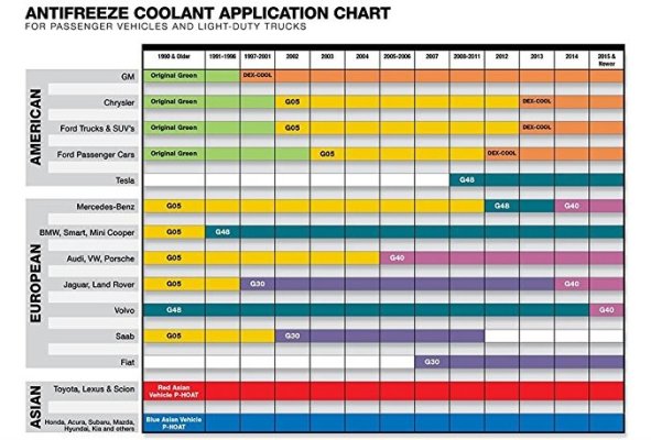

With the fact you are on HOAT coolant in 2012, you should be on 3rd coolant flush at a minimum but the fact it is near impossible to 100% flush perhaps you should be on flush number 5 at this point. I would stick with Mopar hoat or move to GO5 and run rmi-25 with every flush. Sometimes something small like a stuck thermo is the canary in the cool mine and developing a strategy can prolong engine life. I would also inspect the radiator hoses from the inside for any signs of gunk.
Probably needs a thermostat anyhow, but also aging vehicles with 5 year coolants should bump up maintenance. RMI 25 is a leave in product. never use dex coolant, ever.
