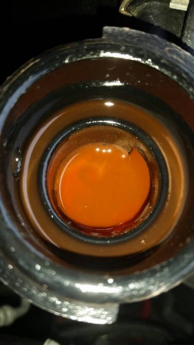

Yep , pretty stupid to put a black coolant and washer fluid reservoirs ?
My wife's 16 Challenger has a clear coolant reservoir tank and you can clearly see it being a bright purple .
My 2014 Ram , however has the black tank , and from what I've read I too should have the PURPLE OAT type coolant .... well I went out and sucked some out with a standard bulb type sucker and put in a clear container , I definitely have the ORANGE , which I believe to be HOAT Coolant ?
Looking in the Radiator cap .
Sucked out and placed into a clear container .
Clearly the ORANGE coolant
As compared to the photo posted earlier per the star report .

This whole color coolant thing is pain in the ....
I have a 14 also and from above with light shining down in reservoir or same with radiator cap off I or anyone would say it's orange in color against the black. I took some from radiator put in clear plastic cup and light from top or front looks orange, lighted from back or cup tilted from back is a purple/pink. Even the black jug of brand new 10yr/150k oat looks orange in jug till poured out purple/pink.
I would have done orange in overflow if I didn't try light tests. Try just a little in clear glass or cup with lighting.

BTW the coolant kinda looks pink....
Burla
Apr 28, 2012
27,513
57,686
2010 Hemi Reg Cab 4x4
Jason, go back and read the thread, you most likely have orange HOAT, which is zerex G05. That would likely be the safest thing to put back, but to be safe do some kind of flushing. Read that last link I posted about dex or dex clone. Chosing to run a lifetime coolant could be a risk, unless you chose wisely, IMO HOAT would be the least risk. But who fkin knows, assholes at Ram replaced orange HOAT with orange OAT, who thought that would be a good idea? Look into what Syn runs, probably the most popular coolant at Bob's, Peak Global Life.
Run a Jar of RMI-25, Syn and Burla approved. Definitely compatable with HOAT.
R.L.K.
Dec 1, 2013
12,803
12,508
Bristol , Tn.
Looks like mine in my 14 ?
HOAT OR OAT ?
I'm thinking it's HOAT .
Did you shine a light on yours while in the syringe? If so did it magically turn purple ?
