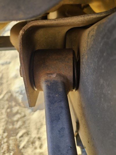

So with one wheel droop:
Rear lower at frame side, look at how much that bushing is doing the work.

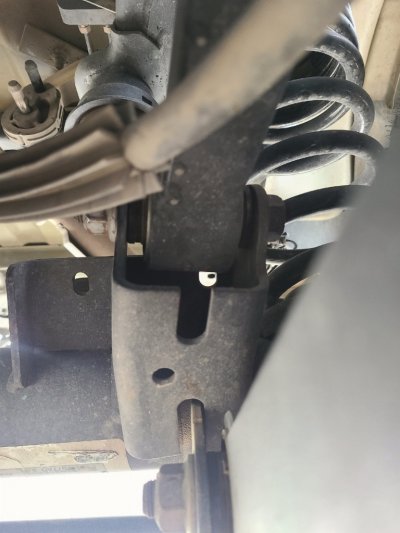

51692928752_4cee2b3f66_h.jpg20211120_112547 by RAM RSM, on Flickr
Rear upper Frame side, the lowers flex a lot more than the uppers but even then look at how the bushing is binding a little since clevite doesn't twist side to side like flex joints do

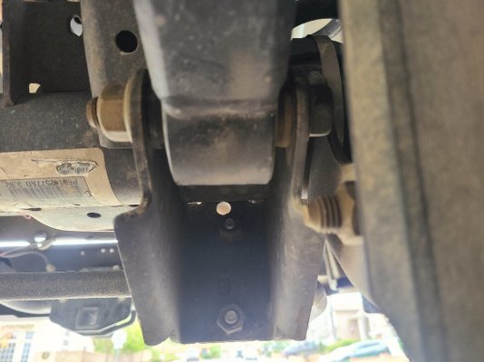

Now lets look at the axel side
Rear lower at frame side, there is a little flex there, but it's not the same as what we see in the frame. I'll say it's virtually nothing in there.

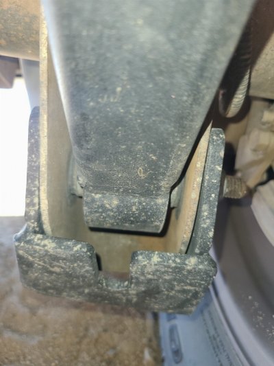

Rear Upper axel side, little flex as well.

The stock rear shocks on my Jeep were 22 1/8" extended, the current rears are 26" so they're literally 4" longer than stock. I'd think this is why mostly every other manufacturer out there with rare exceptions put the flex joint in the frame side.
